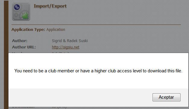

Pues una y otra vez intento descargar la actualización pero pasa ésto:
:blink:
Y desde el repositorio de Sobi, esto otro:
This application is available only within a SobiPro Club subscription.
It seems that you are either not a member of the SobiPro Club or that your subscription has already expired.
If you are a new member of the SobiPro Club or if you have renewed your subscription, you must reinstall the SobiPro core repository and enter the subscription data you've got.
Respondido : 01/05/2012 6:59 pm
