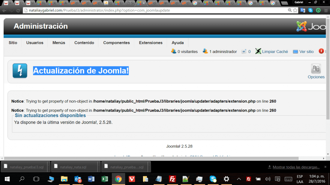

Y ahora en el J2.5, Componente Actualización de Joomla! aparece:
Notice: Trying to get property of non-object in /home/nataliay/public_html/PruebaJ3/libraries/joomla/updater/adapters/extension.php on line 260
eso es a=
$this->latest->client_id = JApplicationHelper::getClientInfo($this->latest->client, 1)->id;
unset($this->latest->client);
Respondido : 28/07/2016 6:01 pm
