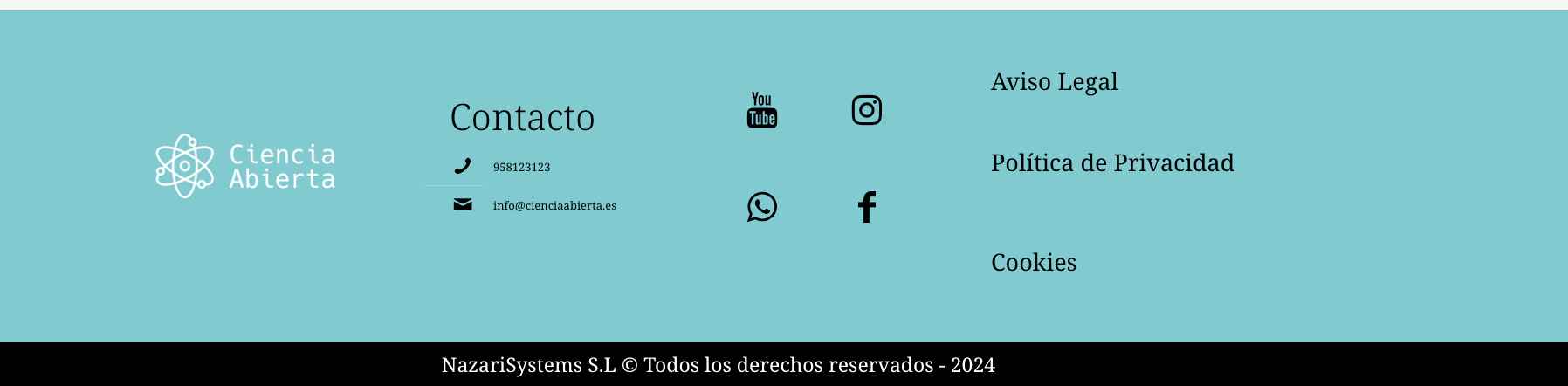

Esto es lo que vemos en el Footer y no se exactamente que estás intentando modificar.
screenshot cienciaabierta.es 2024.06.03 16 56 26

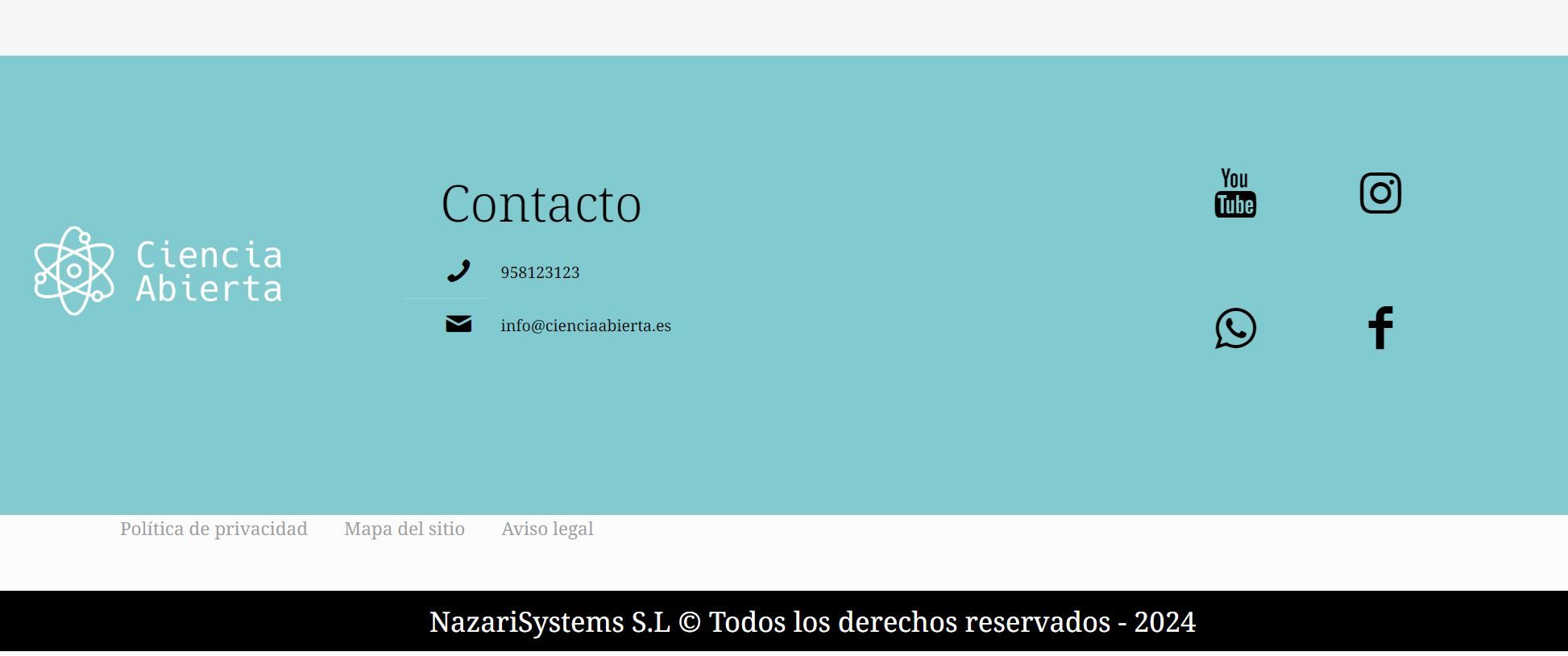

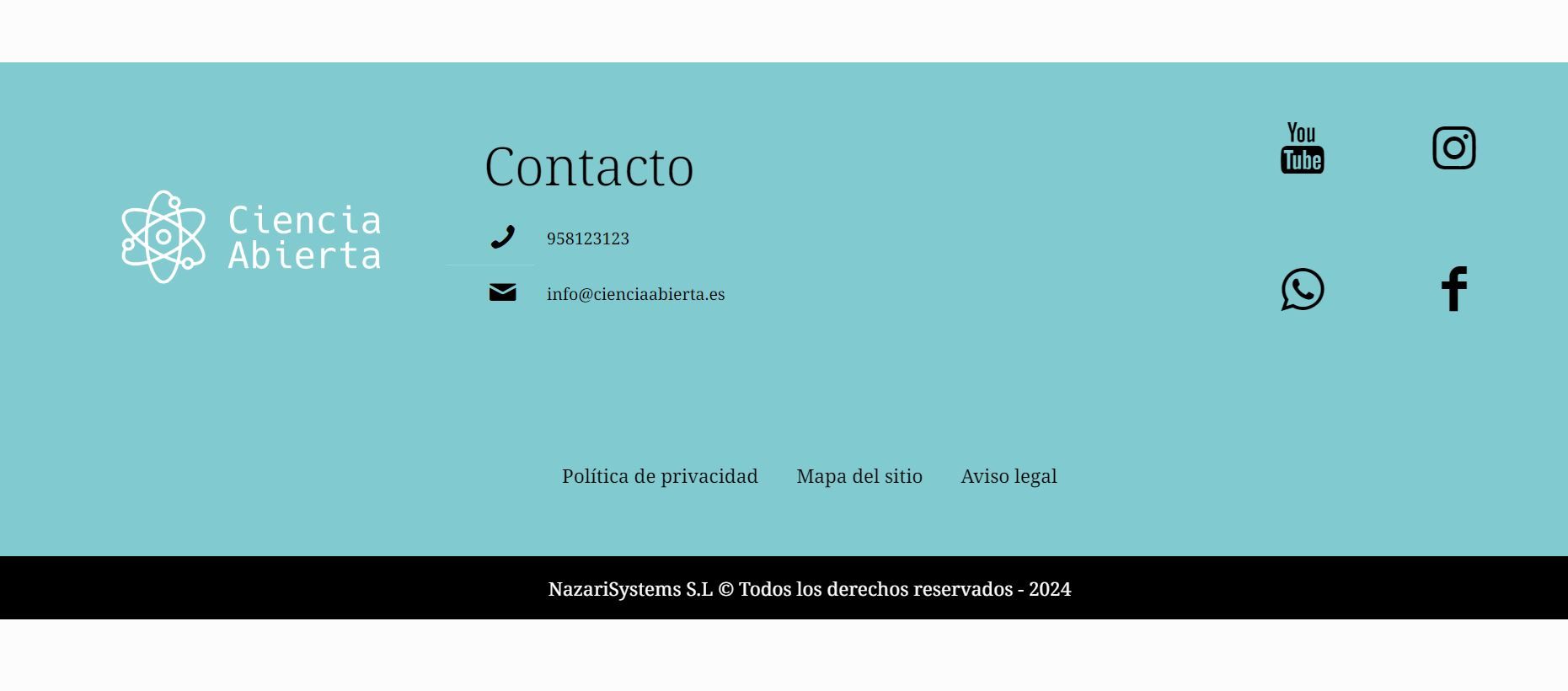

P
footer
 por ejemplo, estoy realizando cambios, en el editor se ve de una manera y en la web de otra.
footermal

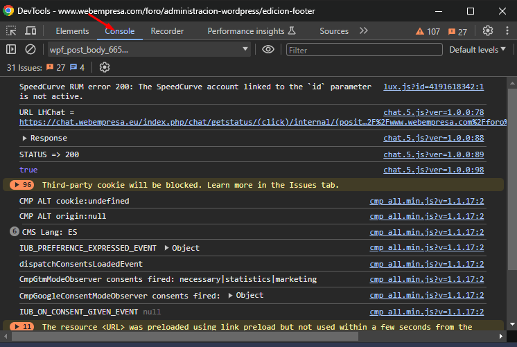

Adjunto lo que me indica la consola de wordpress.
Uncaught ReferenceError: jQuery is not defined
at post.php:2316:8
load-scripts.php?c=0&load%5Bchunk_0%5D=jquery-core,jquery-migrate,hoverIntent,utils,wp-polyfill-inert,regenerator-runtime,wp-polyfill,wp-hooks&ver=6.5.3:5 JQMIGRATE: Migrate is installed, version 3.4.1
tracker.js:1
Failed to load resource: net::ERR_BLOCKED_BY_CLIENT
jquery-migrate.min.js?ver=3.4.1:2 JQMIGRATE: Migrate is installed, version 3.4.1
js?key=AIzaSyAYx-LiNW6Ox71E9dZ42hAp9MKzHnOIFeI&callback=mfnInitMap:235 Google Maps JavaScript API has been loaded directly without loading=async. This can result in suboptimal performance. For best-practice loading patterns please see https://goo.gle/js-api-loading
lca @ js?key=AIzaSyAYx-LiNW6Ox71E9dZ42hAp9MKzHnOIFeI&callback=mfnInitMap:235
maps.googleapis.com/maps/api/mapsjs/gen_204?csp_test=true:1
home_politics_logo_retina.png:1
Failed to load resource: the server responded with a status of 404 ()
